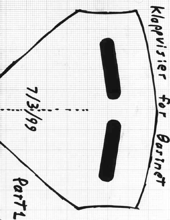

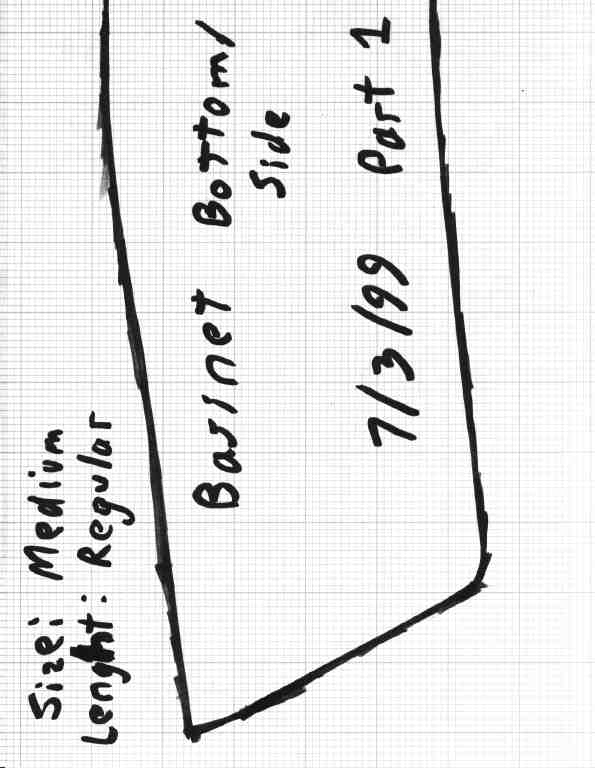

Mid-14th Century style Klapp Visor Bascinet

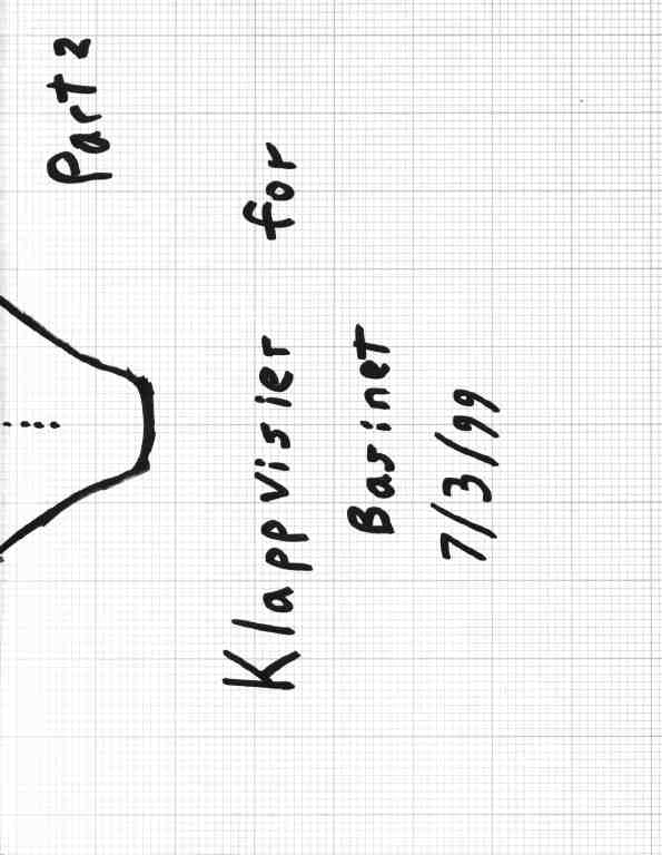

Bascinet Klappvisier P1
Bascinet Klappvisier P2

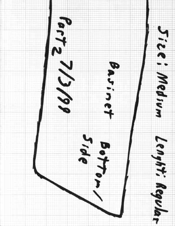

Bascinet Med Reg Bottom P1
Bascinet Med Reg Bottom P2

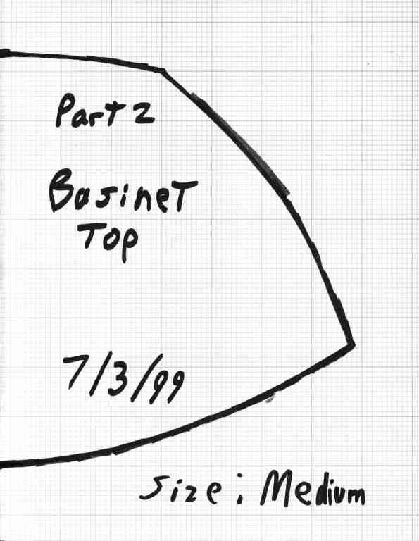

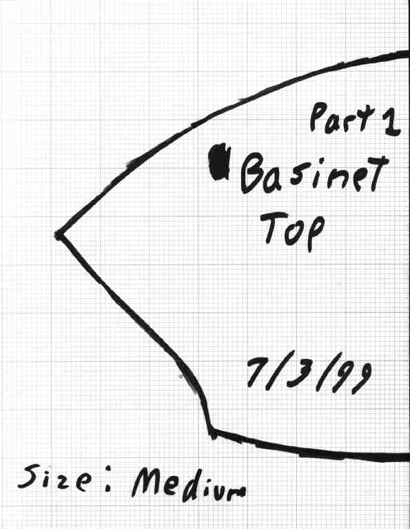

Bascinet Med Top P1
Bascinet Med Top P2
Bascinet Med Misc

  4. Dish and shape the top halves.
  5. Weld the top halves together.

  7. Shape the side/bottom plate to fit the helmet top.
  8. Weld the side/bottom plate on to the helmet top.

  12. Dish, raise, and crease the Klapp Visor face plate then shape it to fit helmet with camail mounting in place.
  13. Punch breath holes and cut eye slots. Flare the edges of the eye slots.

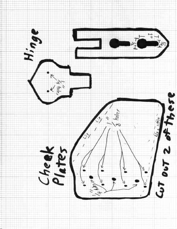

  14. Build the hinges for the two face plates.
  15. Added rivet posts to the helmet will go through the key hole slots on the hinges.
  16. Rivet the hinge onto the Klapp Visor face plate.
  17. Add spring pin on helmet that goes through the bottom of the lower key hole slot on the face plate hinge.
  18. Shape the two cheek plates so that they support the face plate.
