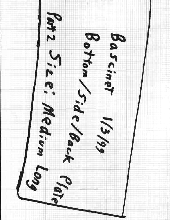

Medium Long Bottom P1
Medium Long Bottom P2

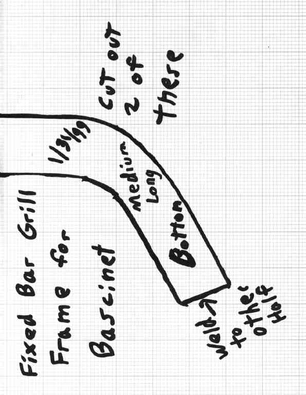

Medium Long Fixed Bar Visor Bottom
Medium Long Fixed Bar Visor Top

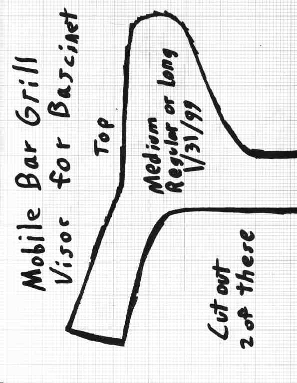

Medium Long Pivot Visor Bottom
Medium Long Pivot Bar Top

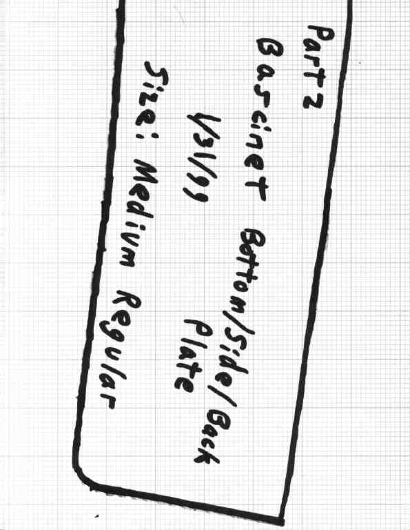

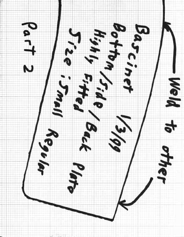

Medium Regular Bottom P1
Medium Regular Bottom P2

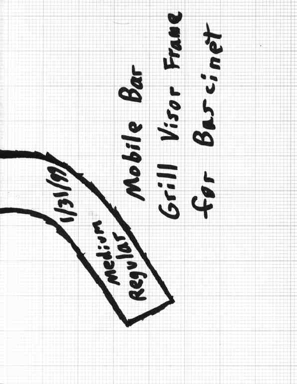

Medium Regular Pivot Bar Visor Bottom
Medium Regular Pivot Bar Visor Top

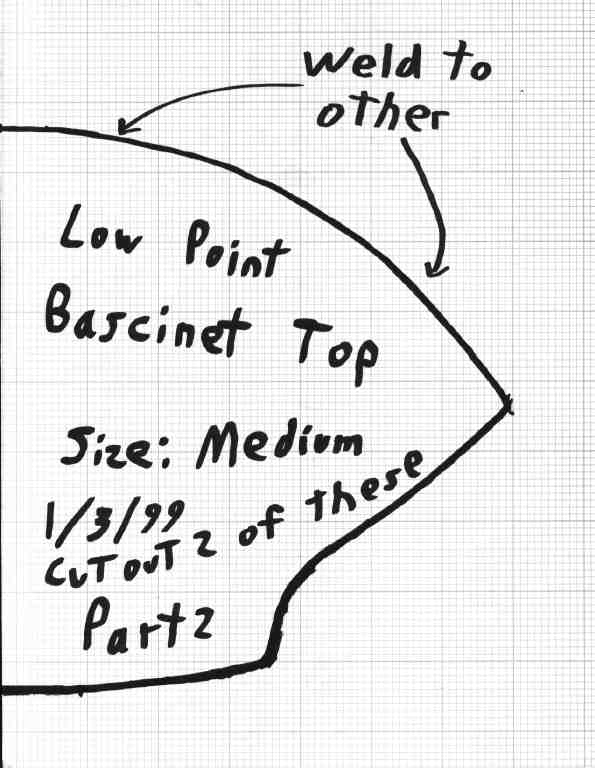

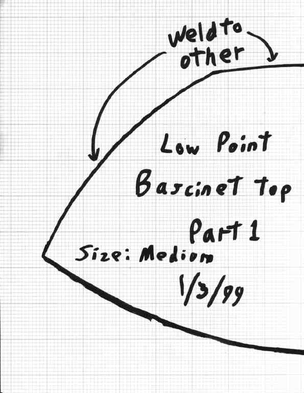

Medium Top P1
Medium Top P2

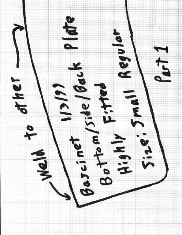

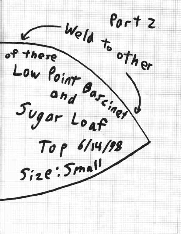

Small Regular Bottom P1
Small Regular Bottom P2
Small Regular Close Fitted Bottom P1
Small Regular Close Fitted Bottom P2

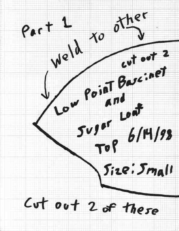

Small Top P1
Small Top P2

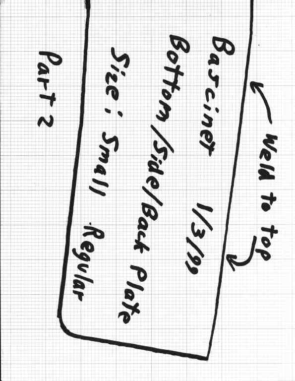

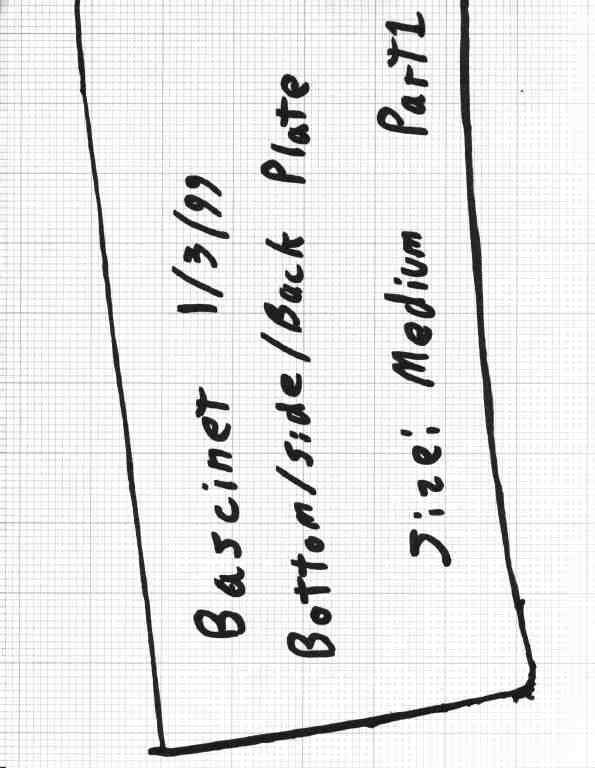

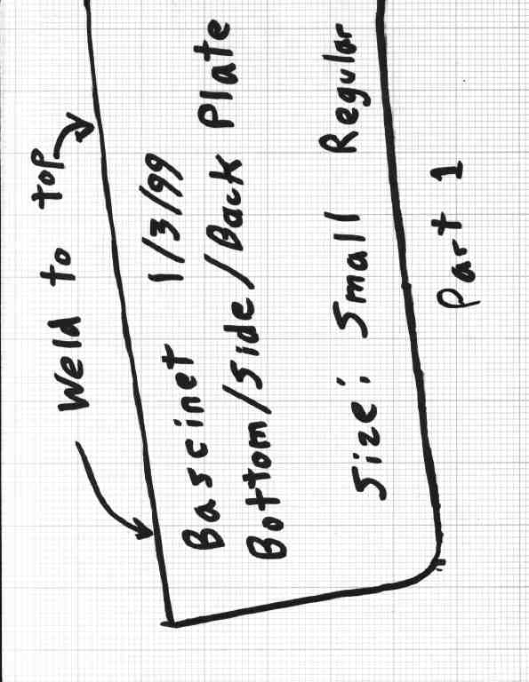

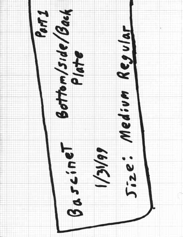

  1. Cut out the plates.
  2. Punch holes in the side/bottom plate for the camail mounting.
  3. Finish the plate edges and corners.
  4. Dish and shape the top halves.
  5. Weld the top halves together.
  6. Grind the weld flush on the outside and cleanup weld on the inside if needed.
  7. Shape the side/bottom plate to fit the helmet top.
  8. Weld the side/bottom plate on to the helmet top.
  9. Grind weld flush on the outside and cleanup weld on the inside if needed.

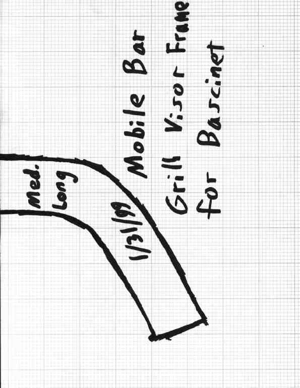

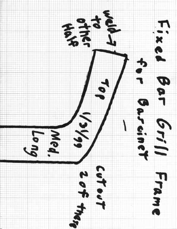

  11. Build bar grill visor and attach it to the helmet.
