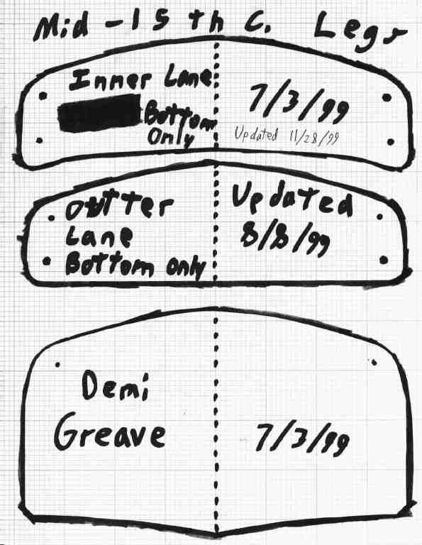

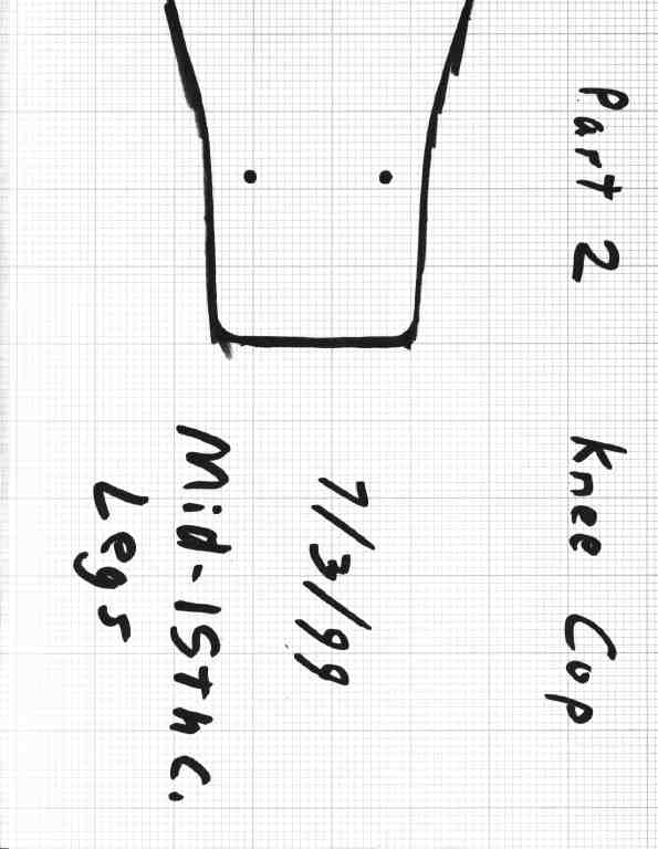

Mid-15th Century Italian style leg harnesses

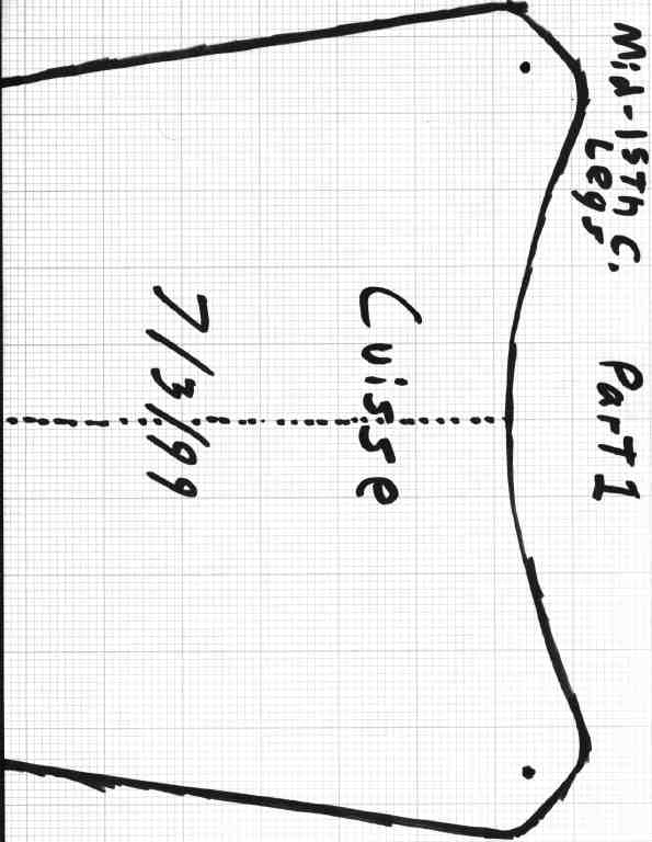

Cuisse p1

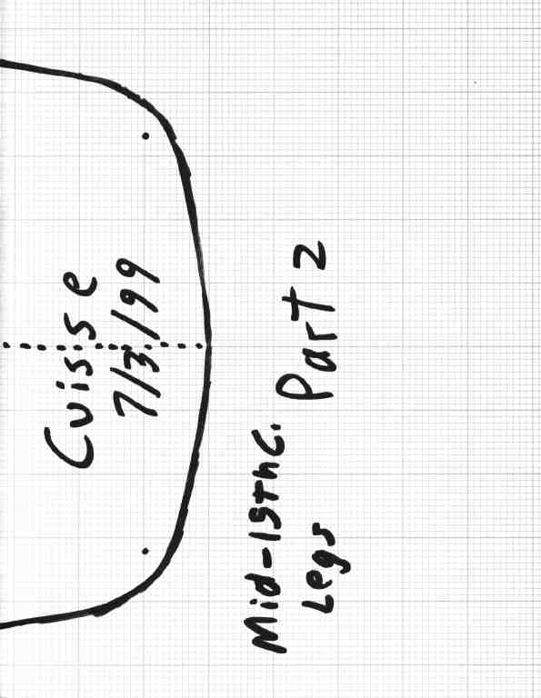

Cuisse p2

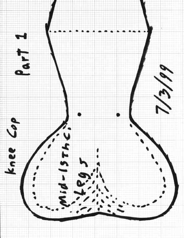

Knee Cop p1
Knee Cop p2

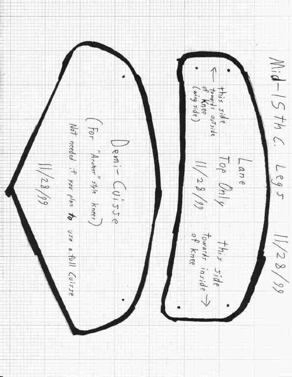

Bottom Lanes and Demi Greaves
Top Lanes and Demi Cuisse

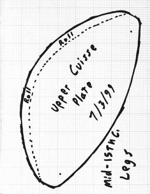

Upper Cuisse

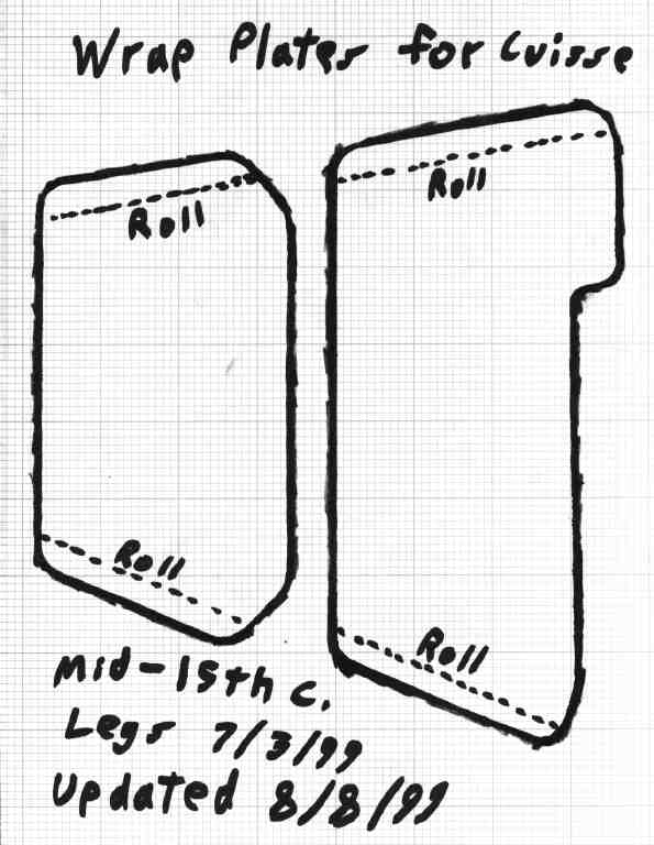

Wrap Plates
  I would build these legs in the following order:
  1. cut out the plates
  2. punch any holes which are on the patterns
  3. finish the plate edges and corners
  4. Roll the top edge of the cuisse and upper cuisse plates. Roll the top and bottom edge of the two wrap plates.
  5. Dish knee cop and shape the wing on the knee cop. Shape the other plates.
  6. Add a crease down the center of the legs.
  7. Fine tune the articulation
  8. Polish the plates
  9. Assemble the legs
  10. Add the straps
