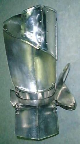

Mid-15th Century Italian style leg harnesses:
Length: 32 inch inseam
Completed: July 3, 1999

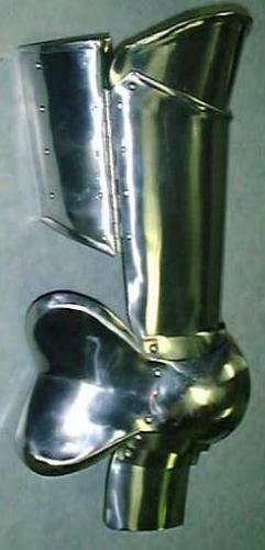

They are made from 304 stainless steel. The demi-greave, 2 lames below the knee cop, and the last (outer) wrap plate are 18ga. and the rest is 16ga.
They are more or less based on the legs seen in the Churburg catalog on suit #18. They are also shown in Arms and Armour of the Medieval Knight By David Edge on a Mid-15th Century Italian suit. A line drawing of the suit is on the following page. Another line drawing of them can be seen in European Armour: circa 1066 to circa 1700 by Claude Blair.
Note the differences between the two line drawings and the pictures. The line draw in Arms and Armour of the Medieval Knight seems to have mistakes. It shows the plate at the top of the cuisse extending down the side and the wrap plates being attached to it.
Knees with demi-cuisse Finished Nov. 1999

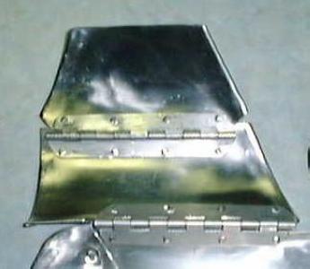

  • Top Lames and Demi Cuisse

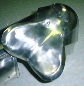

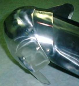

  • Knee Cop
  • Bottom Lames and Demi Greave

    5. Dish knee cop and shape the wing on the knee cop. Shape the other plates.

    7. Fine tune the articulation
