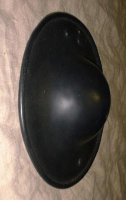

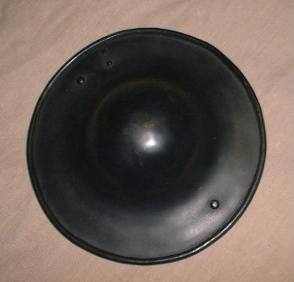

Small Buckler (15th Century Style): Made from 0.050" (~18 ga.) 1050 Heat Treated Spring Steel (Quenched at 1500F, Tempered at 600F for 30 minutes).
Finished Oct. 2000 (Coated with baked on oil)
Finished Oct. 2000 (Painted Black) (Shown)

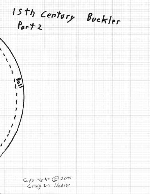

Patterns (Click on a thumbnail to get the full-size image)
