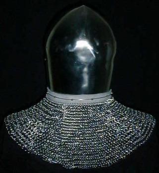

by Sinric
14 ga. Stainless Steel Bascinet: The helmet shown is a size small with close fitted bottom plate. The weight of the helmet is about 6.5 lbs. without camail or 12 lbs. with camail.

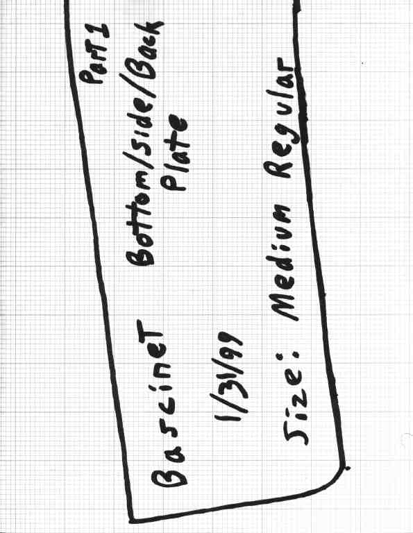

  • Medium-Size Helm: Top Pieces
  • Medium-Size Helm: Regular Bottom Piece
  • Medium-Size Helm: Long Bottom Piece
  • Small-Size Helm: Top Pieces
  • Small-Size Helm: Regular Bottom Piece
  • Small-Size Helm: Close-Fitted Bottom Piece
  1. Cut out the plates.

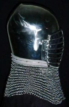

  10. Polish the helmet. (I use 3M surface conditioning disks)
  11. Build bar grill visor and attach it to the helmet.
  12. Add leather mounting strip for camail.
  13. Add the camail (You're on your own with the camail).
