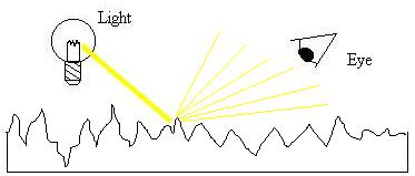

When you look at a beautiful, shiny sword blade or helmet, have you ever wondered why it is shiny?  What makes a mirror reflect?
Basically, the smoother the surface of an object is the more light it will reflect.  Conversely, the rougher a surface is the duller it will appear.  This is because a smooth surface reflects light uniformly, while a dull surface diffuses light.  Why?  Well, if you were to look at the surface of a dull object under high magnification, even one that looked or felt relatively smooth, you would notice that the surface is made up of many peaks and valleys.  The peaks and valleys all act like small mirrors themselves - and many of them direct the light away from your eyes.  This is why the object appears dull:
A smooth object reflects light well and appears shiny.
A rough object scatters light and appears dull.
Why rust makes things dull
Aside from the chemical changes that happen to the steel that make it less reflective, even if you could magically make all of the rust vanish from your rusted object it still would not be shiny!  Why?  Well as we noted above, when the surface of your object rusts first of all different parts of the original smooth surface are attacked.  These patches in turn corrode to different depths.  This has the effect of "roughing up" those patches of steel, in contrast to the shiny, smooth, uncorroded surrounding material.  In reality, corrosion removes material from the surface of your treasured object.  This is why rust so important to prevent - it is permanent damage to the item.

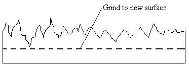

Like I said above - rust damage is permanent.  There really is no way to return the rusted object to its original condition - you can't microscopically fill in all of the rough spots created when the rust ate away the iron that was there.
The only option you have to restore a shine to an object that has rusted is to polish it.  Polishing obviously removes the rust, but it also has the effect of taking all of the mountains and valleys of the rough surface and smoothing them out - you in affect remove enough material until all that is left is a smooth uniform surface again:
It's important to realize that some objects just can't be repaired.  Sometimes grinding away more of the surface is more harmful than leaving things alone.  For example, SCA combat helms are required to be a certain thickness.  If one gets too aggressive when polishing a helm it is easily possible, especially with modern polishing equipment, to remove enough material to make the helm unsafe.  Other objects may have fine engraving on the surface, and polishing these items may obliterate the engraving.  This is why it is so important to protect objects from rust in the first place.
But let's suppose your object can be salvaged.  What is polishing?
What is polishing?
Quite simply, polishing is very controlled grinding.  A bench grinder or sand paper can be considered polishing media.  Very rough polishing media, of course, but polishing media nonetheless.  In order to get a mirror shine one works through progressively finer polishing media until the desired level of finish is achieved.  In fact, in professional armour shops the initial polishing can start with something as aggressive as a machinist's file, and end by using media as fine as baby powder.  This is the reason, incidentally, why mirror finishes usually cost more - they are labor intensive to produce.
