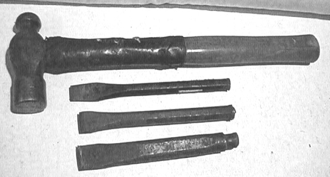

Cold chisel and hammer.
Try it just once. That way for the rest of your life you will be able to say you have.
You can get amazing curves and angles to your cuts, but it is incredibly labour consuming and very loud to boot. On the bright side you do not need to "plug in" to anything at all, and if you need to whip up something armourish at a camping event, these tools are your friends; of course, no one that is camping within earshot of you will be.
Even after you have gotten neat and efficient, there is still a lot of cleanup and filing to be done in order to get less then saw-toothed edges.
Consumables are sweat and patience. You will also need to sharpen the chisel from time to time.
Capacity. This method cuts stainless and mild steel with almost equal success. Will happily do up to 2.5mm material but tends to warp and mangle the 18ga and thinner stuff unless you work onto a wooden block (which eats a lot of the efficiency)
Cost. You can’t do much better without resorting to teeth. A GOOD chisel (one that will not over-harden and shatter or is too soft and blunt) will cost about $6-10US and a good ballpeen hammer from about the same upwards. You can use the hammer for other exciting things as well, though.

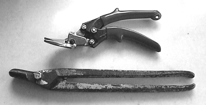

Aviation snips / Tin snips.
The olde fashioned way
Giant tin snips with one "arm" buried in a wooden tree stump are the truly traditional tool for cutting sheet metal in period. It even works if you care to modify a really good and large pair of these shears into such a tool. At anything less then this, these tools are primarily useful for very thin gauge materials in steel or brass decoration. Also useful for aluminium….if you like that kind of stuff.
The major variable characteristic of these tools is the amount of money you are willing to spend on them. The bottom end of the market is made up of soft-as-butter Taiwanese-made snips that you see blister-packed in auto shops and supermarkets. These are as a rule completely useless and should be avoided. At the other end of the spectrum are aviation snips made by companies like Wiss and Prosnip.
Aviation snips are made in specialist varieties to suit the cut being made. One pair is designed for straight lines and very tight right hand curves, while another pair is designed for tight left hand curves, yet a third is a versatile straight and both-ways shallow curves unit. You will probably want to own two or three of these overall.
The advantage of av-snips over standard tin snips is the compound action of the handle, which allows double the cutting power to reach the jaws. It can still be pretty tough going using these though.
I would not use av-snips on steel thicker then 18ga mild….and probably not for too long if I valued my hands.
The edges are usually left pretty clean but can sometimes have little notches if you have been turning tight corners. Some cleanup with a file or abrasive paper is recommended.
How long these tools will last depends on how much you spent in the first place and what you put through them. Even at 18a you are running the tool so close to its capacity that it does not take much to break it
These are ideal for brass trim to decorate armour, though.
Note about traditional tin snips. The turning circle is usually much less tight, the capacity of material is a bit better then av-shears if you spent real money on good tin snips. Record produce an excellent offset-blade model of tin snip.
Cost: Av-snips start at about $15US for a general purpose pair and go to around $25-30 for one of the specialist cutting units. Do not bother buying the cheap and nameless ones. Decent traditional tin snips go for about $30 and up.

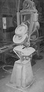

Record brand hand-operated disk-blade throatless shear
This tool is a bit of a rarity nowadays but is worth grabbing if you happen to come across one.
Looking a little like a deranged pair of bolt cutters with disks where the blades should be, this is an English made tool that allows you to work the shears around the steel rather than feed the steel to the bench mounted shear (as is the case with most throatless shears). This thing cuts very nice tight circles but leaves a grooved edge behind on the piece of metal that isn’t facing inwards (likely the armour you want to cut out). The blades need to be sharpened and replaced from time to time and they are now very hard to find as the tool is more or less mythical in this day and age.
Max capacity is 16ga mild. It is hand operated and silent, very portable and you do not need to use too much strength to make it work. Being built by Record before they started getting all their stuff cast in China, the body of the tool will outlast dozens of blade replacements.
Cost. You may find one second hand for about $50 to $100 US. It is a nice addition to a workshop, but I would not like to rely on it as my sole method of cutting out armour.

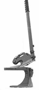

Straight bench shears
SCA group armouring just like the olden days.
I have a special place in my heart for this kind of shear because it is what my Barony owns two of and what we all learnt how to armour with. The place in my heart is one of abject horror at the idea of going back to having to use this tool!
Straight bench shears (as opposed to gay ones, I guess) are a somewhat limited application tool. They will cut endless straight lines and will do outside curves if you put in a bit of extra sweat... but they will not do inside curves of any kind. Ever.
This does amazing things to how you design armour patterns as you desperately try to get around this limitation. You CAN get by with this as your only means of cutting steel... but why not just stick white hot needles under your eyelids for a cheaper way to experience the same amount of joy?
This tool is pretty wasteful of steel but otherwise has no costly habits. Blades should last for nearly all eternity, the thing doesn’t want power, the odd bit of grease in the mechanism will see the shears last and last.
A little more seriously, in combination with a secondary cutting tool like a jigsaw, this is a decent sort of tool. Many brands feature secondary functions like guillotines for barstock or angle iron and even folders and benders for flat stock.
NOTE: The ROPER WHITNEY THROATLESS SHEAR is actually just a straight bench shear. I have no idea why they advertise it the way they do, but really, it is one of these things.
Cost. Depends on what capacity you want. The full range is available. A unit that will cut 2mm mild will cost around $75US new…this can quickly increase to several hundred dollars depending on the model, brand and capacity.
Finish. If the blades are properly aligned (a bit of an art in its own right), the edges should be crisp and clean…this means a bit of a sand down with abrasive paper to round them off is a good idea.

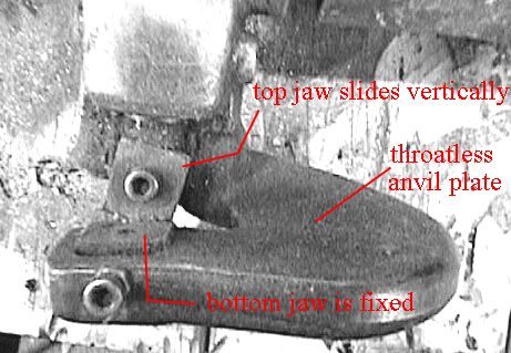

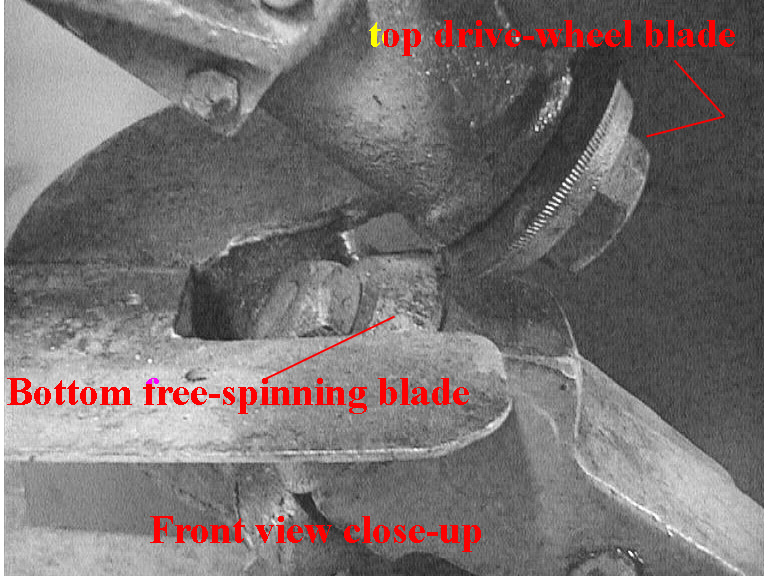

It’s nameless, but it’s blue. This tool is a disk bladed throatless shear that is operated with a lever handle instead of the Edwards’ crank. The brand of this machine escapes me, but the specs are known to me. It is a strictly light duty tool and stresses out at 16ga mild steel. It is reported to leave quiet noticeable teeth marks from the drive wheel on the plates it is cutting. Best described as a can opener with delusions of grandeur. Cost is around $25 higher then the HF shear.

Powered disk-blade throatless shears
A few years ago I purchased a throatless shear over the internet. I thought I was buying the manual Edwards throatless shear mentioned earlier. What arrived had a huge three-phase motor on the top, and so began an adventure of trying to keep all my fingers attached to my hands.
These huge throatless shear monsters are made by a number of companies. My model is by Edwards (English). Ennox, Marshaltown and Pexto also produce similar machines. Cutting capacity is around 2.2mm stainless. Mine will cut a 3½ inch circle…but it takes some practice.
Given the option I would not buy one of these again. Too big, too heavy, too much trouble. I have fitted a pedal control to my unit, which has worked very well. Because of the massive motor and flywheel overhang you will likely also want to fit a small light to better see your cutting lines. The drive wheel can sometimes leave small grooves on the flat of the waste steel near the edge of the cut. This is only relevant if you have butted together patterns that you will want to use both sides of the cut from.
At more then 500pounds for the lighter machines in this category (my own machine is way over 400kg) this is not something you will be taking to camping events with you. Mine has been converted to run 240volt down from the three-phase it was fitted for when it arrived here.
Cost. Around $500US (second hand), plus delivery charges (A big add on in this case)

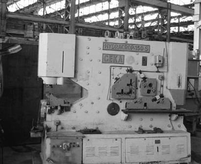

Uni-shear
You know how I mentioned the 450kg monster throatless shear I have? Well, imagine the King Kong type relative of that tool. Now put that imaginary beast on serious steroids! Now you have something approaching the size and weight of a uni-shear.
I know very little about these very heavy-industry toys. But one of our armourers on the Archive has three of them, and has the pictures of the last time he moved house on his website (the Semi-trailer and the large forklift in the front yard just to move the uni-shears were particularly memorable).
If you want to know more about uni-shears and the zoning laws, noise regs and power requirements that you will need to take into account before buying one, talk to MRKS on the archive.
