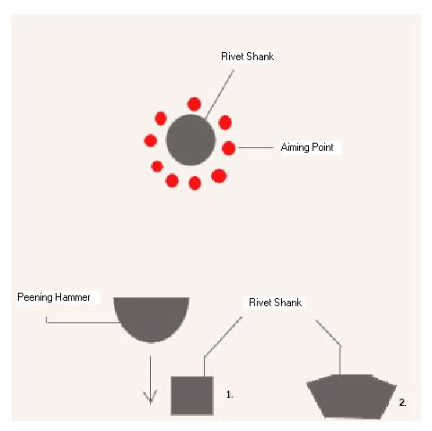

Be certain your rivet is the proper length for the gauge of metal you are using (for most work I use a 3/8 x 3/16) and is properly supported. I use a cylinder head bolt with a divot ground in placed in the pritchard hole of my anvil. This keeps the rivet head round and prevents sliding. Strike the edges of the rivet shank in a circular pattern ( see Fig. 1). Working the shank in this manner eliminates the need for burrs (washers). Continue until the edges have rolled and are no longer sharp. Do NOT strike the center of the shank. This will swell the shank locking the articulation.
